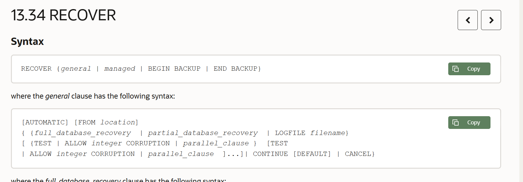

RECOVER AUTOMATIC should do the trick for you
RECOVER_AUTO
but rather than SQL*Plus it seems to me that RMAN would be the better option here.
