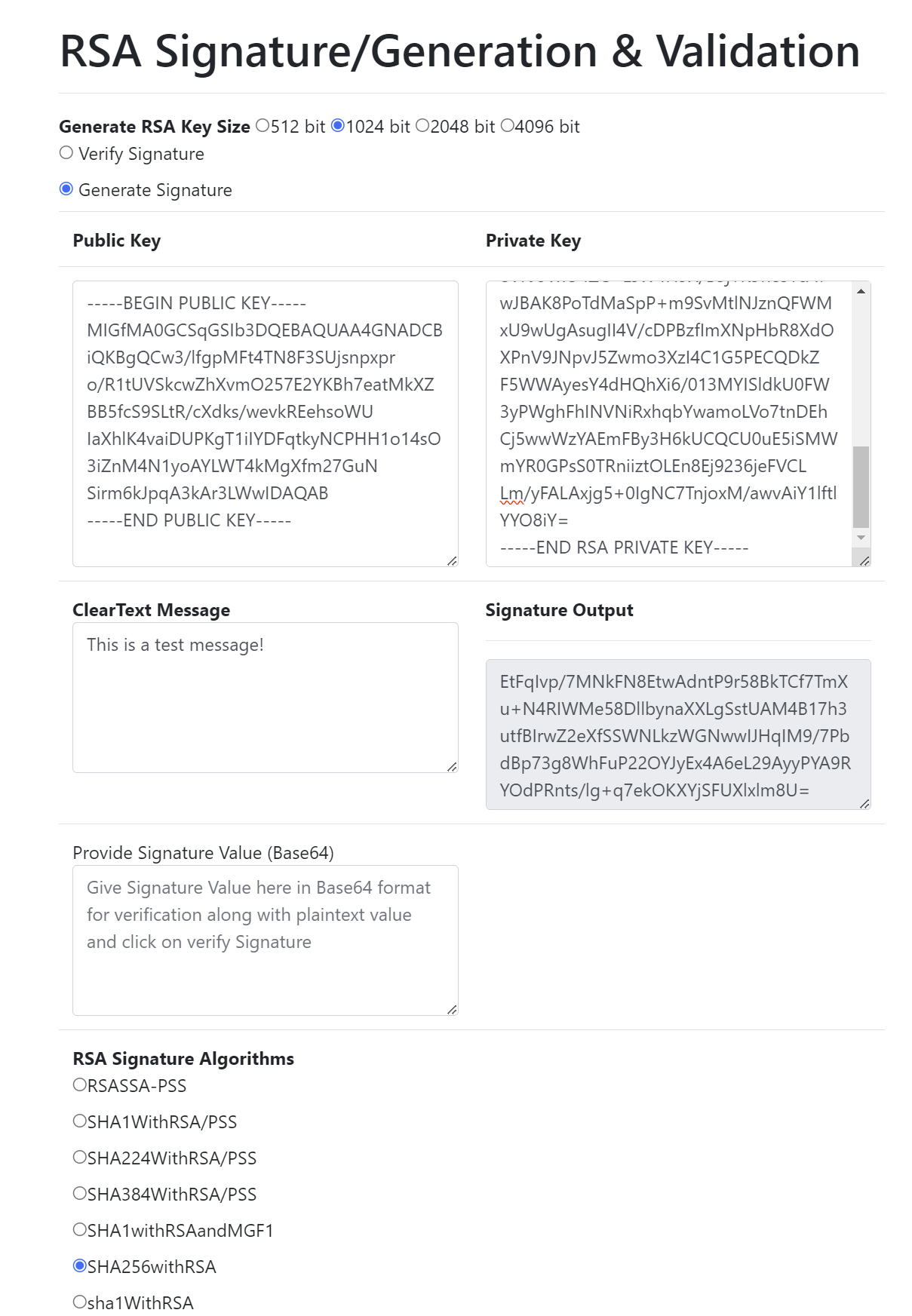

 16  end;
 17  /
EtFqIvp/7MNkFN8EtwAdntP9r58BkTCf7TmXu+N4RIWMe58DllbynaXXLgSstUAM
4B17h3utfBIrwZ2eXfSSWNLkzWGNwwIJHqIM9/7PbdBp73g8WhFuP22OYJyEx4A6
eL29AyyPYA9RYOdPRnts/lg+q7ekOKXYjSFUXlxlm8U=
PL/SQL procedure successfully completed.
I then went to this site for a verify and got the same result.
https://8gwifi.org/rsasignverifyfunctions.jsp
SIGN_SHA256
So fold your code into the demo above and see how you go
