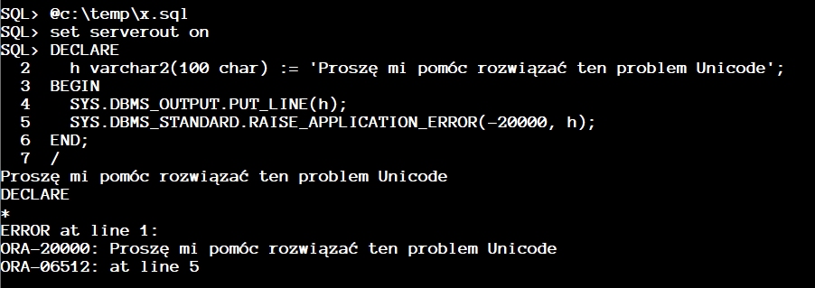

There is nothing inherently wrong in the raise_application_error routine that stops this. For example:
UTF8_ERROR
But that worked only because
a) I ran "chcp 65001" in this MS-DOS command before I started SQL Plus
b) I saved the file as UTF8 and ran that (simply cut/paste doesn't work because its not UTF encoding by default on my machine)
Bottom line - there's a lot of moving parts that you have to get right here
- the database has to support it (my db is running the default UTF8 characterset)
- the client NLS settings must be correct
- the client OS settings must be alignment
My guess its the codepage you'll need to change
