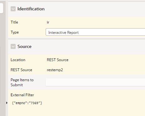

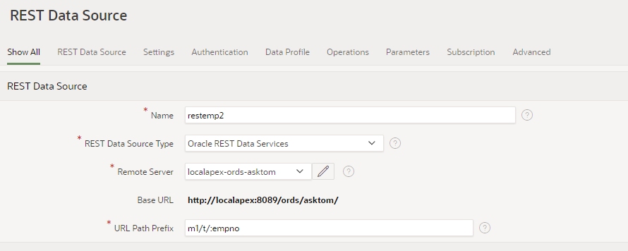

Then created a Rest Datasource in APEX and made sure it was defined as an ORDS one not simple http
RESTDEMO1
and then using it as an external source with filter works as expected
RESTDEMO2

5. Delete the previous and create a new REST Data Source
It is a little bit tricky here – in order to see the last two fields, you should press Tab instead of Next, or you may press Next and then Back to see them.
If the field Value left empty, then on the Discovery step we have an error. Now it is clear that APEX tries to find an endpoint without a parameter.
If you populate the filed Value with USD or EUR or *, then the Discovery step and creation of the data source are performed successfully.
Now APEX is using the right endpoint, but I cannot find a way to override the parameter value. Any ideas?
