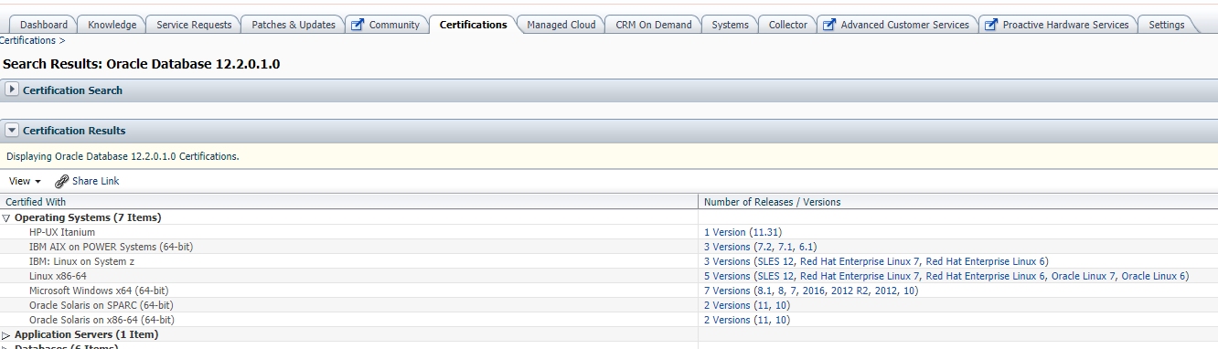

You just need to go the Certification tab in MOS
OS_CERTIFICATION_122

Unfortunately, answer for my second question is not under Certification tab in MOS.
