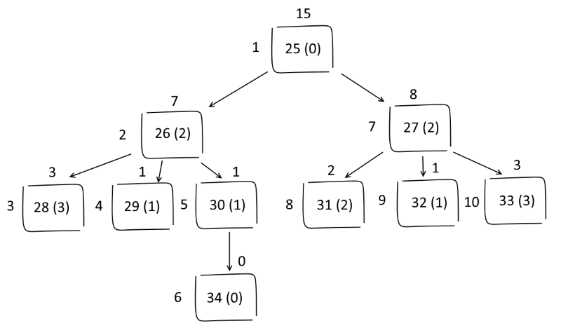

So you want the sum of all the attributes in the subtree below each node, including itself?
When dealing with trees, I find it's helpful to have a diagram showing what you want. So here we go:
TREE_WITH_ATTRS
The numbers inside the boxes are the node ID followed by the number of its attributes (in brackets).
The number above each box is the sum of all the attributes in the subtree below it.
But how do we calculate that?
First, assign each node a sequence number using depth-first search. Showing these on the left of each box in our diagram gives:
TREE_WITH_ATTRS_DEPTH
To get the total below a node, you need to add up the values from itself up to, but not including, the next node that is the same level or lower in the tree.
For example, node 26 is 2nd in the search. You need to add all the attributes between it and 27 which is 7th. So its total is everything between nodes 2 and 6.

CHILD_ID ATTCNT TOTALCNT
25 0 15
26 2 7
27 2 8
28 3 3
29 1 1
30 1 1
31 2 2
32 1 1
33 3 3
34 0 0

Match_recognize still seems to be coming out best though ;)
with tree (reportsto, employeeid, c, tot, pth, lev, FirstName, LastName) as (
  select reportsto, employeeid, by_self, by_self,
         employeeid || '',
         1 lev,
         SUBSTR(c.employeeName,1,1) AS FirstName
        , InitCap(SUBSTR(c.employeeName,3,99)) AS LastName
  from   emp2 c
  where  reportsto is null
  union all
  select c.reportsto, c.employeeid, c.by_self, 0 ,
         pth || '|' || c.employeeid,
         lev + 1 lev
         ,SUBSTR(c.employeeName,1,1) AS FirstName
  from   tree t
  join   emp2 c
  on     t.employeeid = c.reportsto
) search depth first by employeeid set seq
  select * from tree
  match_recognize (
    order by seq
    measures
      first(employeeid) as employeeid,
      first(reportsto) as reportsto,
      first(
        lpad (
          (firstname || lastname),
          (lev - 1) * 2 +length(firstName||' '||lastName),
      ) as nm,
      first (lev) as lev,
      first(c) as attrs,
      sum(c) as subtot,
      first(seq) as seq
    after match skip to next row
    pattern ( strt subtree* )
    define
      subtree as lev > first (lev)
  order  by employeeid
  fetch first 15 rows only;
select * from table(dbms_xplan.display_cursor(null, null, 'ALLSTATS LAST'));
| Id  | Operation                                          | Name | Starts | E-Rows | A-Rows |   A-Time   | Buffers |  OMem |  1Mem | Used-Mem |
|   0 | SELECT STATEMENT                                   |      |      1 |        |     15 |00:00:00.38 |    9234 |       |       |          |
|*  1 |  VIEW                                              |      |      1 |     15 |     15 |00:00:00.38 |    9234 |       |       |          |
|*  2 |   WINDOW SORT PUSHED RANK                          |      |      1 |      3 |     15 |00:00:00.38 |    9234 |  2048 |  2048 | 2048  (0)|
|   3 |    VIEW                                            |      |      1 |      3 |  10001 |00:00:00.37 |    9234 |       |       |          |
|   4 |     BUFFER SORT                                    |      |      1 |      3 |  10001 |00:00:00.36 |    9234 |  1470K|   606K| 1306K (0)|
|   5 |      MATCH RECOGNIZE BUFFER DETERMINISTIC FINITE AU|      |      1 |      3 |  10001 |00:00:00.34 |    9234 |  1045K|   546K|  928K (0)|
|   6 |       VIEW                                         |      |      1 |      3 |  10001 |00:00:00.17 |    9234 |       |       |          |
|   7 |        UNION ALL (RECURSIVE WITH) DEPTH FIRST      |      |      1 |        |  10001 |00:00:00.15 |    9234 |  2250K|   697K| 1999K (0)|
|*  8 |         TABLE ACCESS FULL                          | EMP2 |      1 |      1 |      1 |00:00:00.01 |      76 |       |       |          |
|*  9 |         HASH JOIN                                  |      |     24 |      2 |  10000 |00:00:00.07 |    1824 |   996K|   996K| 1273K (0)|
|  10 |          RECURSIVE WITH PUMP                       |      |     24 |        |  10001 |00:00:00.01 |       0 |       |       |          |
|  11 |          TABLE ACCESS FULL                         | EMP2 |     24 |   9472 |    240K|00:00:00.02 |    1824 |       |       |          |
Game, set, and match_recognize
