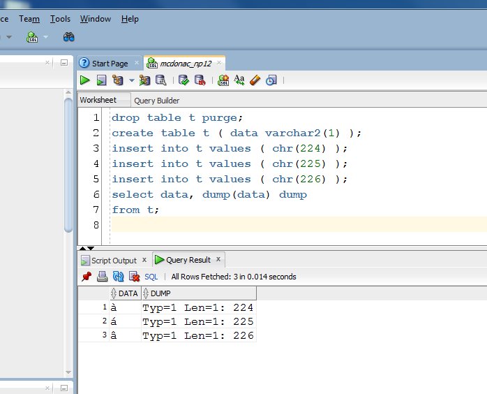

You need to be very careful when dealing with "lossy" character sets, ie, ones that cannot hold all the information you need. Just because we store the data does not mean it will be correctly represented later.
For example, consider the following 8bit characters (stored in my database which is WE8MSWIN1252, ie, an 8bit charset).
NLS_CHARS
If I select them back to a client with NLS set to US7ASCII, then I'll get 'a' for all three results, ie, I'll lose all the accents etc. Similarly, if I stored them in a US7ASCII database, they would still probably be stored fine, and possibly even displayed fine, but that is "good luck" more than anything else - we're relying on some bits to align. If you need to style multibytes characters, then you want the entire database to be a multibyte charset (like UTF8) or you would use the N-datatype columns (nvarchar2,nclob).

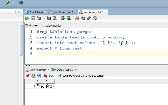

The example you gave for example, is fine in both cases for a *multibyte* database (eg this is my UTF8 database)
NLS_CHARS2
